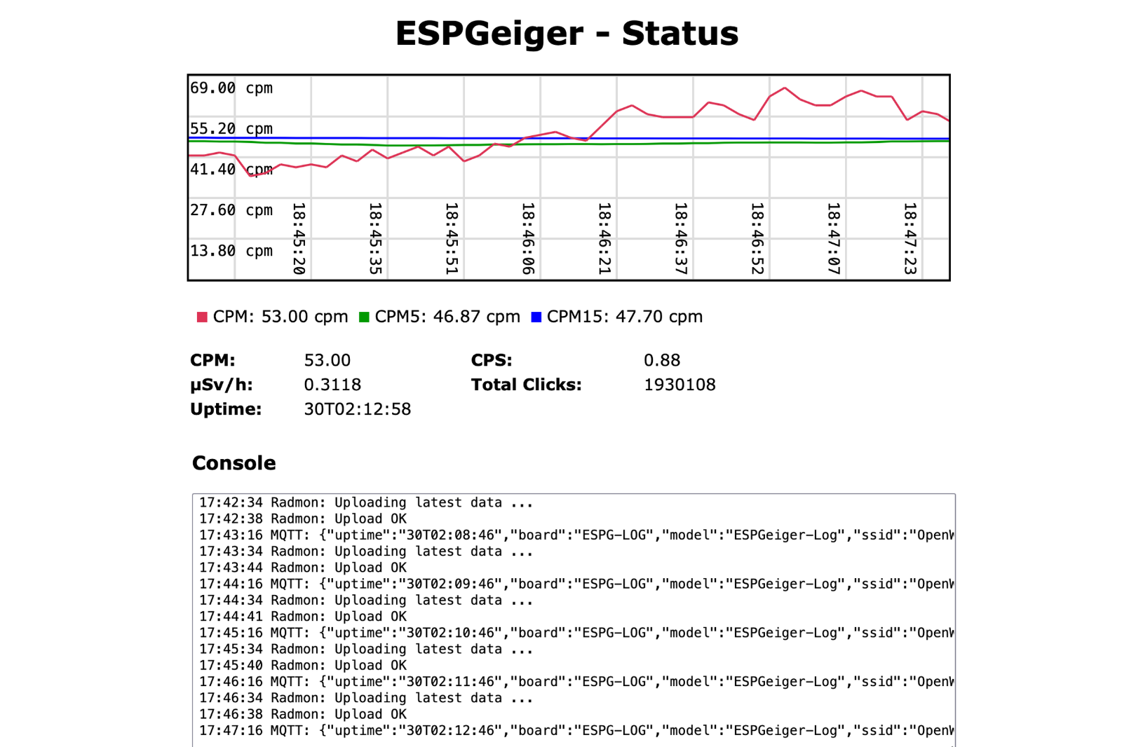

This seems like a good opportunity to advertise ESPGeiger, which is a firmware for ESP8266 and ESP32 devices to collect, display and distribute collected count statistics from a compatible Geiger Counter.
To start, you'd need a ESP device (I personally like the ESP8266 Wemos D1 Mini (v3.0) and similar clones) and a compatible Geiger Counter - the Cajoe range of counters are cheapish and seemingly reliable.
Check out the documents here https://docs.espgeiger.com and the repository over at Github
ESPGeiger gives continuous monitoring and submission to local MQTT and Radmon, as well as others. A local webserver is enabled, which enables you to interactively view the data as well as exposing all the relevant information by JSON.
If you'd like to give it a go, all that would be needed is a ESP8266 and compatible Geiger Counter - the firmware installation can be done via your browser by visiting https://install.espgeiger.com
There's the documentation and a couple of posts in the forum if you want a bit more information - I'm also happy to answer anything here.
If you were happy with the firmware and wanted a bit of a cleaner package, I have created a simple development board, ESPGeiger Log , that features an OLED screen, Neopixel and SD card output - making the whole ESPGeiger experience neater -
