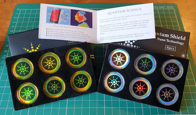

They came in a box with a leaflet telling me how fantastic they are. 'Get it today, care about healthy today!'
They are very pretty and change colour with differing the light angle.
However, disappointingly low CPM at only between 85 and 120 CPM (5 min average.)

They come as a pair, with a different pattern on each side.
They are very floppy and bendy.
They are too big to be able to see the display on the Geiger counter.
And they are measly active at around 160 CPM.
Last edit: 1 year 11 months ago by Simomax.

btw background is approximately 15 CPM
1 year 10 months ago #7084
Replied by Simomax on topic Latest (and last) Round Of Negative Ion Scalar Energy Ju-Ju - Moar stickers!
Wow, nice! They are pretty active. What Geiger tube are you using?

Replied by Mercator on topic Latest (and last) Round Of Negative Ion Scalar Energy Ju-Ju - Moar stickers!
I have a SBM-20 on 400 V
