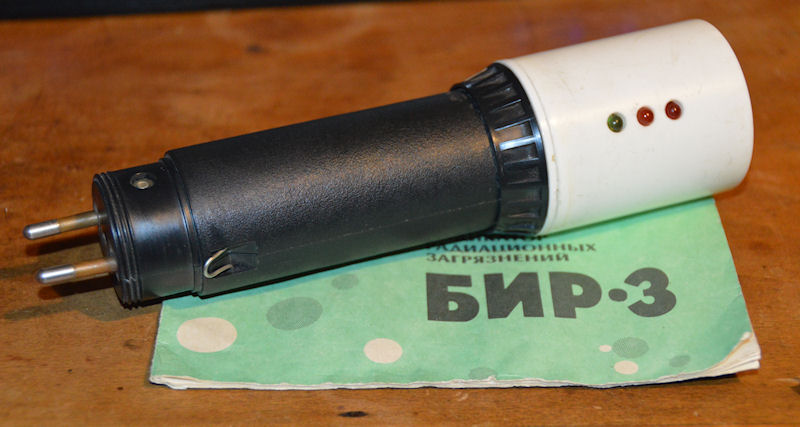

I found this on ebay priced at £12.52 delivered and couldn't resist at that price so I bought one for shits and giggles! Probably the most bizarre counter I have bought yet. (Apologies for the camera focus - new camera, very complicated...  )
I haven't powered it on yet as I have no idea what battery it should be, if it should be a battery at all. It has US mains plug pins on one end but there is nothing wired to it, nor is there a battery cover. The only way to put a battery in is to disassemble the unit, which is rather cumbersome. It looks to be a flashlight made into a counter, but comes with a printed manual. Almost as though a company has been using flashlight cases and putting a counter inside. It is almost like a PSU has been taken out. Really strange. Everything about it seems homebrew, but it has proper instructions that I need to translate and the cover does state 'Domestic Indicator Radiation Pollution BIR-3' and even has BIR-3 moulded into the end of the white part.
It has three LEDs, red, orange and green and what looks to be a sounder. The sounder, if it is that, is beneath a hole drilled into the end of the white part, I assume to let the sound out! I think the sounder may be an alarm to sound at a certain level, as opposed to a clicker. The construction of the unit as a whole is crazy! It does have what looks like a mini SBM-10 GM tube, which is nice and some very old ceramic ICs. When I get chance I'll try and power this up and see what the ICs are and if the thing works or not. Very strange counter indeed!

One of the strangest counters I have ever seen. It almost looks like its been cobbled together out of existing parts and modules. then someone hunted for an enclosure. The tube (the component with wires round it) looks like an SBM10.

Looks like a EU plug and not US. The US plugs are flat and not round pins.  I'd guess 220VAC but before I plugged it in I would check the capacitors to see if they look crispy! With age often comes breakdown and it could pop like a firecracker if something is shorted.

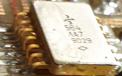

Very interesting. A combination of the custom package IC on the gold lead frame carrier is quite strange. The odd components almost look like cylindrical thermal fuses but I doubt that is what they are. May be capacitors in cylindrical cans. The one part with the wire wound round the can appears to be the detector or a quartz crystal oscillator. Possibly to clock the ASIC in the gold package. The piezo buzzer would indicate counts and the LED's likely show low, medium and high counts. If the can with the wire is the detector it's not very large and I'd wonder how sensitive it could be. The other large can seems to be a capacitor but more pics would be required.
The bulb base to screw into the power adapter may have been an early universal power adapter concept. Perhaps have other components in the lower portion to regulate a power supply for the upper part? At least my best guess. Have you tried to power it up yet? I would probably take a video in case it went up in smoke!

Russia uses the same power connectors as Europe i.e. type C and F aka "Europlug". The standard voltage is 220 V and the standard frequency is 50 Hz.

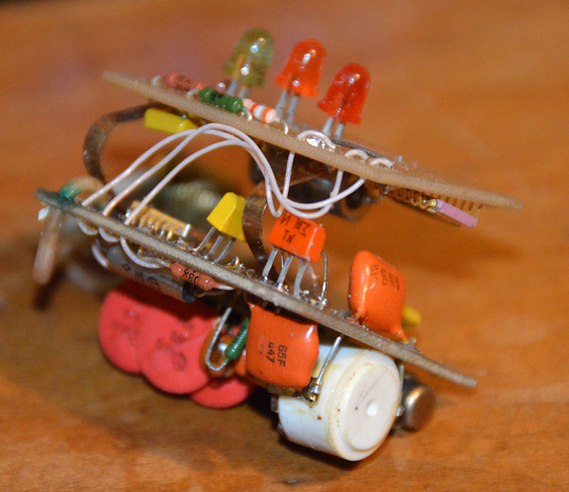

I have managed to power this up and it does work!   I have also started reverse engineering it a little. I removed the two (brass?) strips and replaced them with wires so I can flatten the board out properly. The two strips were connecting the ground and VCC on the boards together. I haven't yet translated the manual, but I will in due time as I can't find a single thing about this counter on the internet at all and the info may be of use to others' too. In all it seems like a very basic counter with a quirky display. If I knew what the ICs actually were I could maybe replicate this on a breadboard. One of the ICs I now have some clue with, but not the one on the HV/detector board.
First, here is a video of the unit working. This is running from a 9v battery just pushed against the terminals on the bulb connector. It will run from a 3.6v lipo cell also, but the sounder and LEDs are quite weak, although it does actually detect radiation fine at that voltage.
Interestingly, the orange LED doesn't light orange, but red. The camera picks this up as a different shade of red, but there is little difference to my eye.
I have identified each type of component. The packages whilst similar to the common packages we know of, these seem quite crude in their composition, even for 1990. But this was probably designed and built in the communist USSR era, so would explain that with it being 'domestic' kit.
This is the HV PSU with transistor tagged on the end. It is a separate board piggy-backed onto the detector board. As the tube is an SBM-10 (verified as measurements are exact against my known SBM-10) then my assumption is that the HV board generates around 400v. Below that is what I think is the HV transformer. It looks like a coil wound around a wire-wound resistor - very creative! There are diodes that are hard to see next to the large disc capacitors on the HV PSU. This would be a simple pulse generator and voltage quadroupler circuit (two voltage doublers in series.) Hmm, I wonder if that IC on the detector board is used as a ring oscillator to trigger the transistor on the HV PSU? That's plausible.
Below is a transistor, and next to that a small signal diode. Probably similar to a 1N4148 but looks to be the same on the HV PSU board, so they may be higher voltage than that. Maybe something like a 1N4004 or 1N4005.
Now, this component got me for a while, until I started tracing the circuit. I'm pretty sure this is a 5V zener diode (I could be wrong.) This is in series with the sounder. From what I can tell the signal goes into a resistor, then the 5V zener, then the sounder. This would make sense if the sounder was rated at 5v with a supply higher than that, such as my 9v battery.
And finally the two ICs. The first is from the HV and detector board. I have little idea what this is or does. It resembles something of a ring oscillator, but there is a lack of capacitors for that. It is much of a puzzle but may be the oscillator for the HV generation. I would have to reverse engineer the actual circuit for that (which I may do in time.) Whereas the 2nd IC is on the display board and I am pretty sure that is something like a logic binary counter. I come to that assumption from the pattern of the LEDs. orange comes on, goes off, red comes on, goes off. both stay off for a bit and both come on, then it starts again. 4-bit binary counter maybe? Its interesting as if I remove the source when an LED is lit they just stay put, as would happen with a binary counter.
I really need to translate the manual as I think that may add some details that I'm missing. Its all quite interesting.
