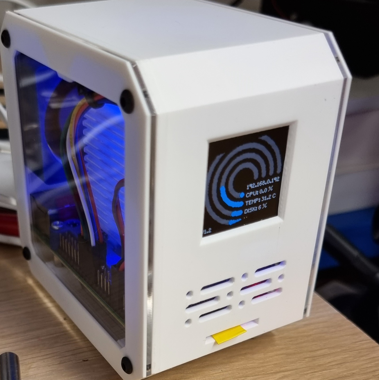

BTW great that you use a Raspberry Pi to host Radmon. I'm a big fan and run lots of things on my Pi 4 server. Here is mine in the case I designed & built. I notice your temp is quite high at 77.4 C . This is quite close to the throttling temp (80 C) so I'm curious to know if you have a heatsink / fan / case for it? My temp sits at 47 C but the case does have two fans!

4 years 3 months ago #6165
Replied by mw0uzo on topic API endpoint to read a station's last reading (for Home Assistant integration)
It runs fanless, and it's summer. So it runs very hot. It's got heatsinks all over it, so it never quite gets to throttling. Without the heatsinks it would be throttling almost immediately! But, even though it's scorching hot, it seems pretty reliable. It is slightly underclocked, I had an early version that wasn't stable at rated clock frequency.
The temperatures probably don't help the SD cards though.
The case did have a ventilated cover, but it restricted airflow too much. So just the base of the case is used to hold the board.
One of those machined heatsink cases with fans would probably be ideal for it...
4 years 3 months ago #6166
Oh, and that case. That is excellent!!! Nice work
