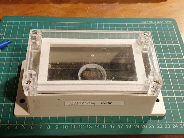

This was a fairly well controlled experiment that was carried out at home, and using ChatGPT as my lab sidekick. The idea was to capture Radon progeny from 4.46g of Uraninite (Uranium ore) and prove the decay products. Uraninite emits Radon gas and this decays into other daughter radioisotopes, such as Pb-214, Bi-214 and Pb-210. The experiment took around 25 hours to complete, including write up and photos.
An airtight chamber (electrical project enclosure with a gasket seal) is used to house the Uraninite source, sat on a pedestal, approximately in the centre of the chamber. Above the source a layer of sellotape is suspended with the sticky side facing the source. A single layer of activated carbon pellets cover the floor of the chamber. A Radiacode 101 was initially used for the first spectrum, and then a Radiacode 103 was used for the other spectra. A NetIO-GC10 MK1 with a SBM-20 GM tube was used for detecting soft beta - β⁻. The Radiacode 101 was calibrated prior to the experiment and the Radiacode 103 calibration was confirmed before use.
Enclosure used for the experiment. An electronics project enclosure with gasket for air tight seal.
Placement of the Uraninite source and activated carbon pellets along the floor of the chamber.
A layer of sellotape was stuck to a foam board frame and held in place with friction. The sticky side of the sellotape faces the Uraninite source.
The completed enclosure, sealed tight.
