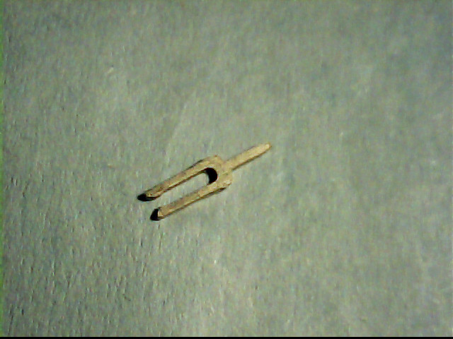

Hello,
I got failure with my 2 years old geiger station due to contact oxydation and female pin headers problems.
My station was a homebraw diy kit + Arduino with ethernad pad connected with wires. Unfortunately, oxydation started to randomly create contact problems. It was issued with F2 contact spray.
The second problem added many questions about the origin of random working state of my ethernet board. Mainly it's because of femalle pin headers bad quality. If you break a single row square female pin header, you will find the origin of random behaviour in your electronic DIY board.
Wires connected on female pin header quite a long time would increase rate of female pin deformation and lost of contact.
I guess it could be usefull to know that because we find many of this female pin header on the market. Most arduino board are made of.
Best regards
Xfrog
Best regards
Xfrog
