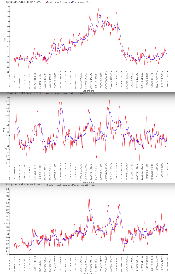

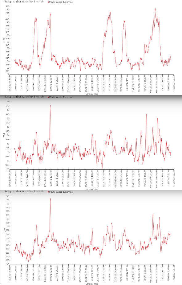

For the past few months I have had my three monitoring stations in the same location, and since they all have different GM tubes we will be able to make some interesting comparisons.
See the Month charts below for stations southofhobart, southofhobart2 and southofhobart3 respectively. The data in each chart is for the same time period.
2x SBM-20 attached to an air filter (top), 1x SBM-19 (centre) and 4x SI-180g (bottom)
And weekly charts for the same stations below - even more variation

I have thought that to be the case, thanks for confirming it.
I have played about with a handful of GM tubes and besides the difference in sensitivity, some seem to pick up Beta more than others, same goes for Gamma. I didn't really think that different GM tubes would pick up background radiation so differently though, sensitivity aside. Maybe some behave differently with muons?

That's really interesting, thanks for this. It seems to show how the filter extends the duration of the detected particles, probably due to the fact that many of these decay products are charged and 'sticky' as a result.

Simomax, they probably do have differing sensitivities to muons, just like they do with beta and gamma. The surface area, thickness and composition of the GM tube walls, the anode size, orientation and perhaps coating.
The over-all count rate of any given tube seems to largely be governed by the tube surface area.
Bert490, I saw that too. Those sticky radon daughters, they just hang around in the filter decaying away.
I think the filter is a fairly accurate account of the dose that must be accumulating in your lungs.

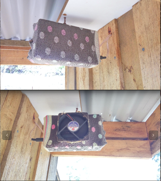

The air filter used for the charts above is pictured below.
Installed under my (solar) battery house eave.
