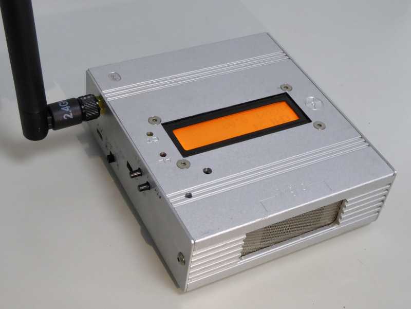

Hi,
I am in Manchester UK and have just built an Arduino IDE Geiger Counter based on a kit I bought as ebay item 152426754731 from user impexeris.
The detector tube is an SBT-11A (alpha, beta, gamma), biased at 430V, with the mica window exposed but behind a 0.3mm thick 50% transmission stainless steel mesh.
The detector is usually indoors at home, or at work about 3 miles away. Home cellar reading is 2.4 counts per minute higher than on the upper floors, work reading is consistently 8cpm below home non-cellar reading.
Data is logged via an HC-05 Bluetooth module to either Radiation Logger on PC or plotted on Android using the Visual Logger app,
Andrew.

9 years 8 months ago #2883
by Gamma-Man
Nice built. /Carl

9 years 8 months ago - 9 years 8 months ago #2889
Replied by mw0uzo on topic New user from Manchester UK
Welcome Andrew!
It's all set up for you.
That's a really nice build you've done there!

9 years 8 months ago #2893
by G4LVI
Replied by G4LVI on topic New user from Manchester UK
Thanks for setting up the account. Once I get bored with the usual pitchblende, smoke detector Am source, low sodium salt experiments with paper, aluminium and lead shielding I will leave the counter logging to the site long term, hopefully outside.
