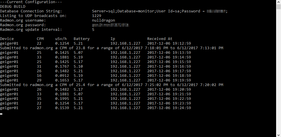

Replied by nulldragon on topic Hello from Wellard, Western Australia
It works!
I've also completed the first version of my data logger software!
I've got my nodeMCU reading the serial data from the GK-mini, feeding it into my local wifi via a UDP broadcast. ( I know I could submit this direct to radmon.org, but where is the fun in that
Which is then being listened to by a .net core command line app which logs it to my database, as well as calculates a 5 minute average of all samples and uploads it to radmon.org
Graphs are underway, I just need to sort some moving averages, and accumulations of uSv per period
Fun times!

8 years 10 months ago #3720
by Juzzie
Replied by Juzzie on topic Hello from Wellard, Western Australia
Well done, good fun
