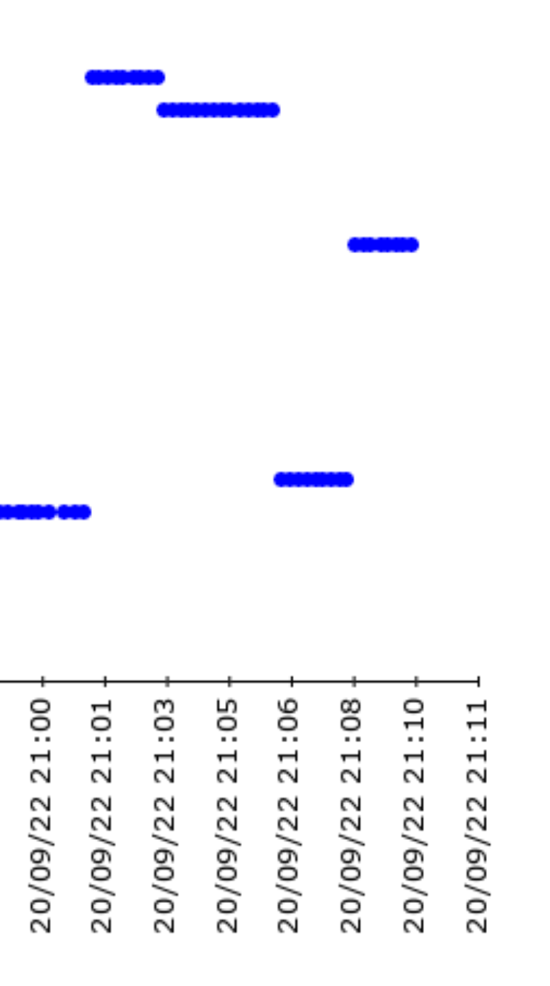

Comparing the SBM-19 and SBM-20 tubes, the SBM-19 appears to be about 4x more sensitive:
https://www.pocketmagic.net/tube-sbm-19-%d1%81%d0%b1%d0%bc-19/
https://www.pocketmagic.net/tube-sbm-20-%d1%81%d0%b1%d0%bc-20-geiger-tube/
So your CPM values seem reasonable for a SBM-19 tube.
However, viewing the plot of the "Last hour of raw readings for deedee", it appears that your station is uploading each CPM value repeatedly, generating much more load on the radmon.org server than it should. You may have a software bug or a misconfiguration.

4 years 1 month ago - 4 years 1 month ago #6227
by deedee
Replied by deedee on topic Difference between CPM Multigeiger and CPM Radmon map
Thanks for yor reply. I can adjust the upload frequency. What upload frequency is right?
I have a multigeiger. The data are uploaded by a separate nodemcu, that runs an asynchronic webserver and also shows the value on an lcd. I need to add a separate procedure that handles the upload frequency.

4 years 1 month ago #6228
by deedee
Managed to fix it. The weird drops in my graph had to do with the procedure that grabs the value from the dataserver from sensor.community. Sometimes it has not yet updated, which means that my procedure returns 0.
I have included a condition that it only uploads a value if cpm >0.
4 years 1 month ago - 4 years 1 month ago #6229
by Bert490
Replied by Bert490 on topic Difference between CPM Multigeiger and CPM Radmon map
Hi deedee and welcome to Radmon. Nice job fixing the drops issue. I think what nu3e was getting at is that your Radmon update procedure appears to be grabbing values from the dataserver about 8 x faster than the sensor.community database is updated (see attached image).
Last edit: 4 years 1 month ago by Bert490. Reason: clarity
