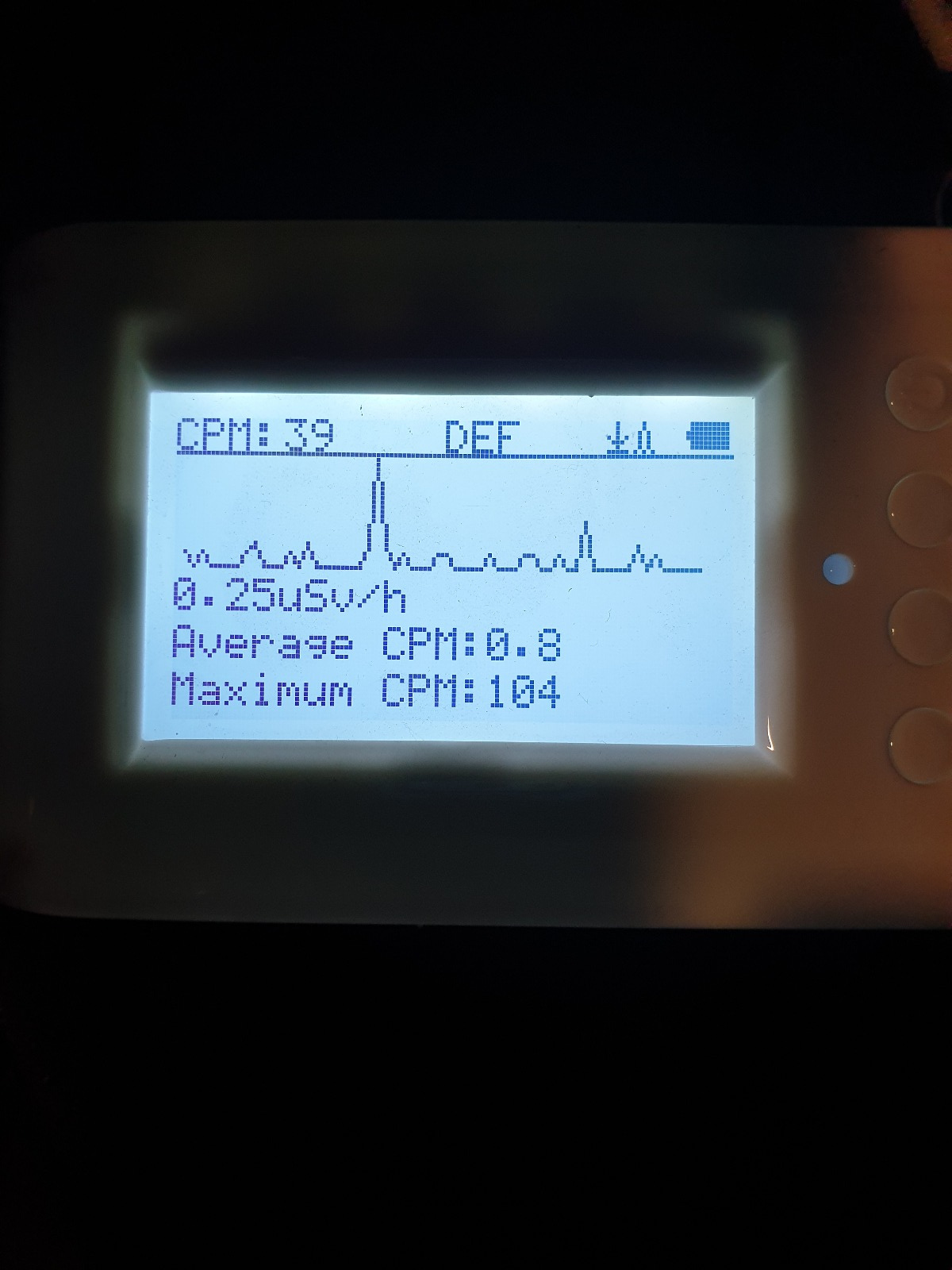

7 years 8 months ago #4297
by meteopedara
Hi to all. Finally I managed to get him to talk to Radlog. I set the GMC 500 at 57600 and also Radlog. As you can see from the attached photo. But there is a problem, as you can see marks strange numbers even if the correct size 500. I did a total reset but it does not change anything. Some idea?
Replied by meteopedara on topic Problem with software
We need to determine what the difference in behaviour is between the GMC500 and the other models. I don't have a GMC500, so can't find out directly myself.
The GMC500 manual might tell us, what is the default baud rate? It may have changed with the new model.
Also, Microsoft have broken the way old serial ports work in Windows 10. It could be related to this, e.g. the auto installed driver just does not work with the older .NET serial port code.
It will be a bit annoying, but to make progress you will need to battle with RealTerm until you can communicate manually with the GMC500. Then we can send it some commands to see if what is sent back has changed.
