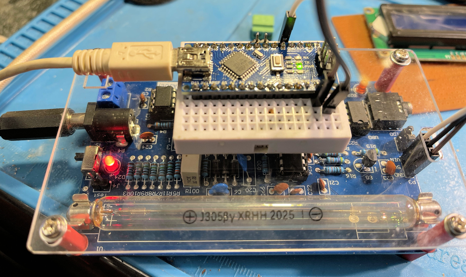

I bought a new CAJOE counter with J305 a few months ago, hoping it would be light sensitive. Sadly it's not in the slightest. So I have one that is very sensitive to light, and one that isn't in the slightest. The older (2021?) is the light sensitive tube, the new tube is not.
