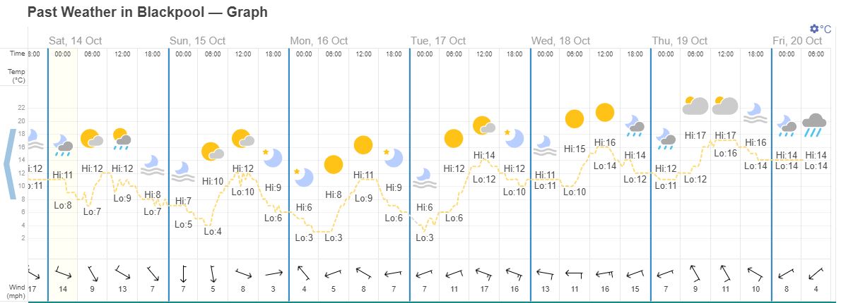

This is from the web. The past week of weather data for Blackpool. I live very close to the coast (1.68 miles) and our air is usually very clean. I'm in a 0% Radon area. Whenever I have seen this kind of thing I have always assumed a cosmic event or something. I have four other counters running at home in my office at the moment. None of them picked up anything. This is the weather for Blackpool over the past week:

I did manage to get some historical weather for the 17th and 18th when the event(s) started happening. See images below. I very much doubt water ingress/humidity would be the case. The unit is quite well sealed up (99.9% sealed?) It has some Kapton tape over a slot in the front of the case and temperature changes can bee seen by the Kapton tape being sucked in and outwards. The buttons/switch/cable gland are all super high quality hermetically sealed military grade parts, all with their own seals. I will check it over though this weekend. Maybe wipe all the cobwebs from it.
