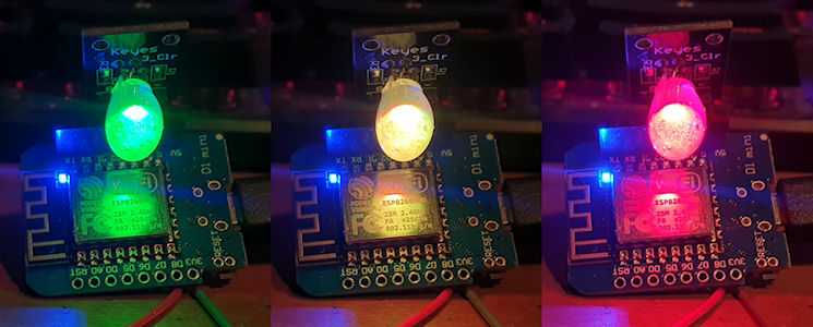

I knocked up a simple monitor to easily see if radmon.org is up or down. It uses an ESP8266 (Wemos D1 mini clone) and a single RGB LED. It simply polls radmon.org by asking for a response from the server. If it gets the reply it is expecting in a timely manner it lights the LED green. If it doesn't get the reply it wants, or times out, the LED changes to orange and sets a fail counter +1. If it receives the correct reply again it goes back to green, but after 3 consecutive failures the LED lights red. There really isn't much more to it. There are positions in the code where an alarm or something else could be activated and also deactivated. It has two modes - lightweight or not. In lightweight mode (lightweight = true) the monitor calls a simple HTML page with the text 'pong' in it. The other mode (lightweight = false) sends a query to the radmon api and the request is processed by radmon core. It then chucks out the same 'pong' for the monitor. The latter method uses more CPU cycles so unless some specific testing is being done the lightweight mode works fine.
The LED is one from a kit or something. It has the resistors already on the PCB with the LED, so make sure you use the right resistors for each colour of the LED if you decide to make this. The LED was very bright (clear type) so I threw a splodge of hot glue on it to diffuse it. Now it looks a little like a small glowing grape as it sits at the back of my breadboard!

Great little project. I may have to duplicate! Only thing I can see as a potential add is to include a watchdog timer. On ESP projects they work for a week or two then seem to get lost! At least that is my experience. I normally will have checks for my local network as well as a standard watchdog reset if the code gets lost. Makes the nodes a bit more robust.

A watchdog may be a good idea. Not something I have really had to use on my projects though as I rarely have any lock-ups with the ESPs. I have had code that crashed an ESP at random intervals, but never really have them lock up. That said, I used to occasionally have them drop off the WiFi, but that all went away when I changed my WiFi APs for a much better quality make. So generally I have some code that will reconnect the WiFi if it looses connection, but that is about it. I have also had issues in the past where the AP going off line would stop the ESP reconnecting, but that may be more down to the older code/libraries and also my lack of programming skills back then or maybe something to do with using older APs back then. I do think having a good WiFi network is kind of paramount with these small WiFi nodes as I have had ESPs online for 100's of days.
