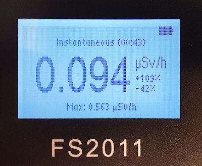

Hi Gissio,
Success! I have managed to backup the original firmware and flash your Radpro 1.3.0 on to my FS2011. It was pretty easy and all worked first time following your instructions. It was harder downloading the drivers for the ST LINK dongle as they wanted details, email etc... Meh.... It appears to be working well so far, much better than the stock. The original firmware was reading double uSv than it should have been. I think the conversion factor was set for the HH614 tube and not the (clone/copy) J305 that was fitted. Comparing to a couple of other counters I have laying about, your Radpro 1.3.0 appears to be reading correctly now. I have since fitted an original J305βγ as I broke the original tube trying to remove it. The tube still works but the metal caps have fallen off each end. I can still use it but I'll have to crimp some wires onto the wires coming out of the tube. I will probably do this and refit it at some point.
I couldn't find my Gigaohm resistor (somewhere in my empire of dirt/workshop) but I did read the voltage before and afterwards anyway. With the meter burden it was reading 176.4 volts and with your Radpro 1.3.0 it is reading 179.8. I have fitted new batteries since reading the original though so that could be the discrepancy.
Cheers, Simomax
Hi Gissio,

Replied by Simomax on topic Custom firmware for the FS2011/FS9000/NR-950/YT-203B Geiger counters
Something to note: I can't read the tiny text easily. It's too small. I have to wear reading glasses due to surgery I have had on both my eyes in the past. I usually wear +1.25 (+1 - +1.5 are fairly standard) for the computer/general stuff, but even with those the text is too small. I have to wear +3.5 (these are strong magnification) glasses to read the tiny writing effectively. This is due to the focal length of the reading glasses. For my +1.25 the to focus properly the counter (or any subject) has to be about 2 foot (60 cm) away from my eyes. I can see the text, but it is very small so I struggle to read easily. Wearing my +3.5 the subject has to be about 10 inches (25 cm) away, and the text is very readable.
I don't think this will be an issue for young people, but some people will probably struggle to read the tiny text. No biggie though as I can read the massive text without my glasses!
