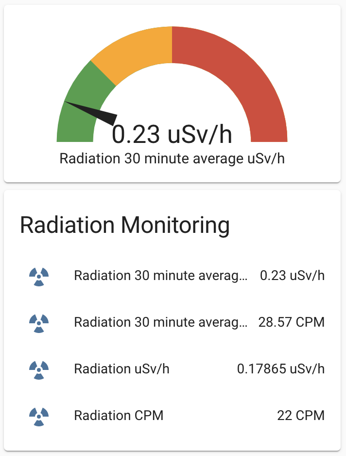

I have used the radmon.org API and created a "command line" sensor that displays radmon station data within the Home Assistant (HA) application.
Home Assistant is an excellent open source smart home hub that you control. You can create automations and alerts and control everything in your home.
See: https://www.home-assistant.io/ ( I am not connected to the project or development group )
The integration configuration code is in in my github: https://github.com/rjelbert/radmon_radiation_homeassistant_integration It's pretty cool to see live data appear in the HA control screen. It also means that HA users can see radiation levels even without having to install their own sensor.I'd be interested to know if anyone else is using or experimenting with HA.

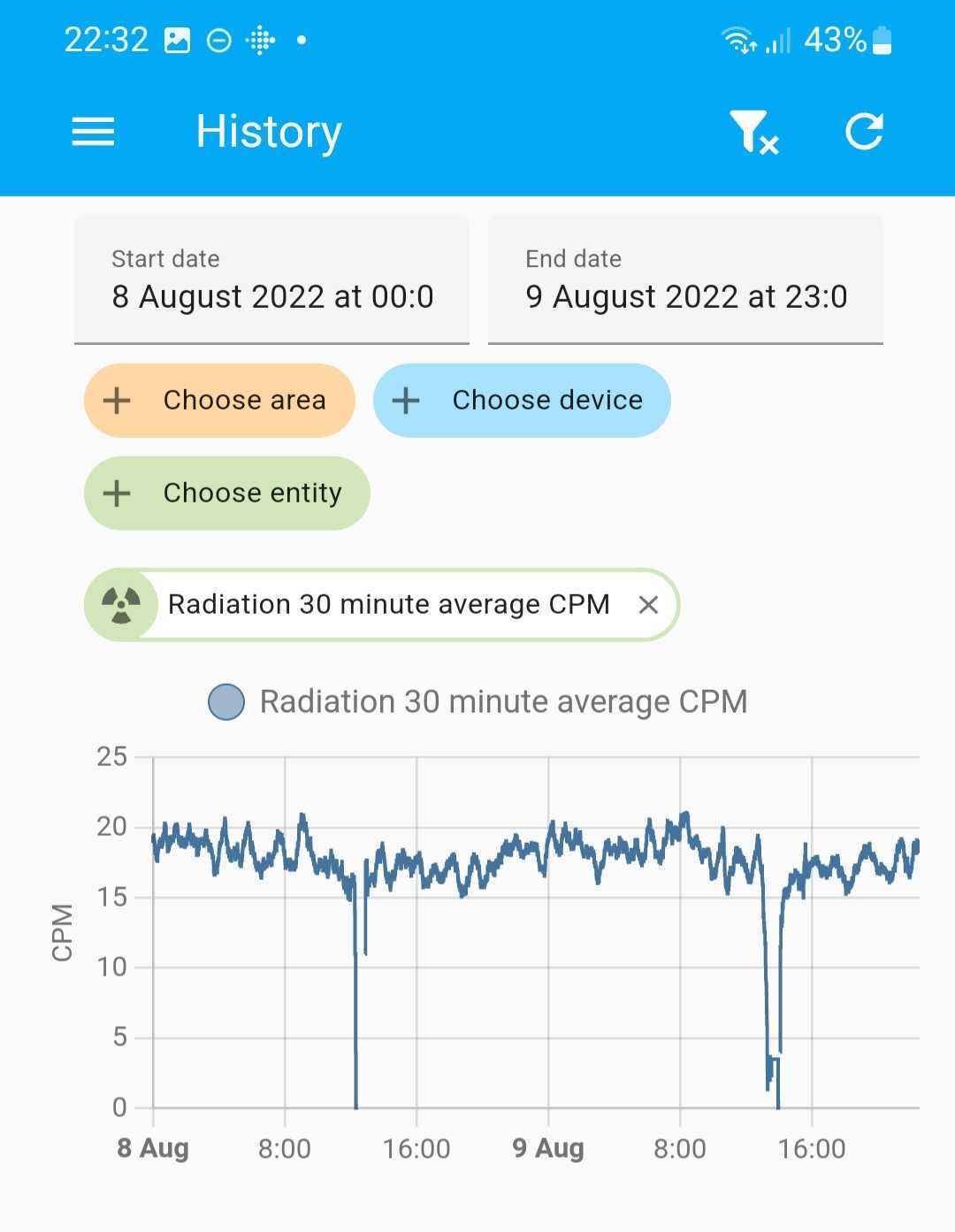

Unfortunately I'm having some problems with my Geiger sensor at the moment. It keeps cutting out most days for an hour at a time just reading zero. I changed the tube so it must be the PCB or perhaps the high voltage generator. The intermittent nature of the fault makes it hard to debug! The arduino part seems to be working fine - just no clicks.

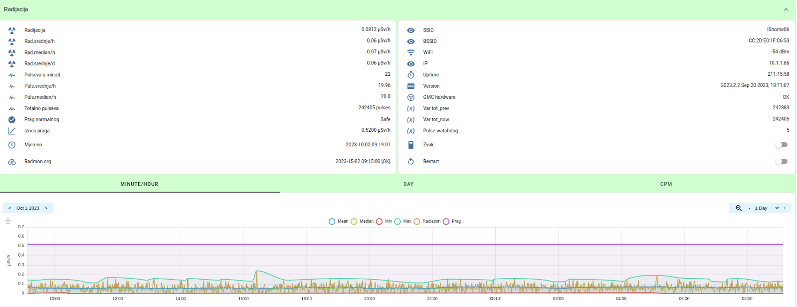

I built ESPHome interface to chinese RadiationD v1.1 (CAJOE) with J305ß tube .
Now I have per minute data about radiation (CPM, μSv/min, μSv/h, μSv/day) in the Home Assistant.
Also, once per hour, Home Assistant send average CPM for past hour to radmon.org.
I programmed warning level and if reached, warnings are issued by TTS and mobile notifications.
