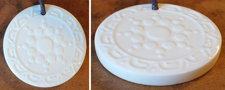

This is the latest Negative Ion Energy Ju-Ju pendant. It's kinda pretty.   It has some extra goodness on the back - some Germanium stone and FIR stone little dot kinda things. One of the previous stone coloured pendants has 4 little dot things also. This one came in a basic box with the usual blue plastic authenticity card. Nothing else. Get one here if you want:  https://www.aliexpress.com/item/4000030351480.html

I suspect this is made in the same way as the other pendants, only using different materials. It looks like ceramic, but it is a resin mix. It doesn't feel cold to the touch like ceramic, and also has some bubbles in it (shown below) which pretty much proves this was poured from a liquid. It is very smooth, much smoother than the stone coloured pendants. It sounds a little like ceramic when hit with a metal object (lightly of course!) but just doesn't have that higher pitch ring like ceramic has. I suspect it is something similar to composite wall tiles,  but with added quantum science negative ion Ju-Ju goodness!

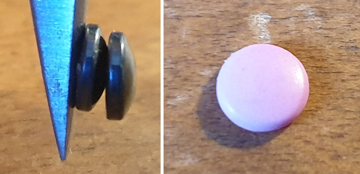

The little dots on the rear are stuck down with a thin layer of quite flexible glue and they were easy to prise off. The little black dots are magnetic. The sales pitch states the dark dots are Germanium . They aren't. Germanium is  diamagnetic , not magnetic. Germanium is also a silver-white colour, not dark grey/black.
This is Germanium:
Here you can see the two black dots and the pink dot. I suspect the pink dot is also some resin composite and the same for the black dots after looking at them under a microscope.
I measured the pendant and the little dots with Geiger counter. The pendant is hotter on the rear than the front, but not much at only 0.65 uSv/hr. The black dots show no radiation but the pink dot does. This came in at around 0.3 uSv/hr, so for it's mass it is more concentrated than the whole pendant. I haven't put this under my Radiacode to see if this is Thorium or something else ass I suspect it is Thorium. Everything I have had so far from Aliexpress

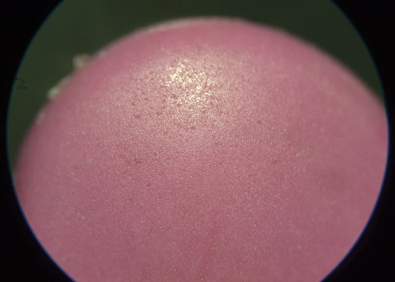

Then I looked at the dots under the microscope. Both the black and the pink dots appear to be a similar composite resin as this and the other pendants. They do not appear to be solid minerals that have been polished. You can see what looks like pouring marks on the rear of the black one. Also apparent on the pink one, but not as much.
And finally some microscope images of the pink dot at greater magnification:
