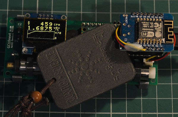

I checked with my Panax RM202 with a CV2247 at 470V. I know the tube is gamma only. Integrated over 25 seconds, I got 1.5cps, normal background is 0.8cps. A pack of thorium mantles gave 5cps, my hottest source (Ra226) gives 450cpm. My BR-9B gives a background of 0.15uSv/hr & 0.45uSv/hr with the disc on the tube side.

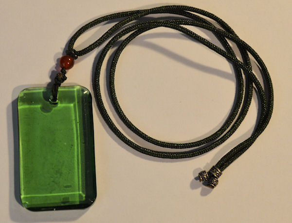

EBUTY Square Glass High Negative Ion Necklace Green Glass Quantum Energy Pendant 5000+ Ions Healthy For Men Woman
This was £10.03 from Ali Express including shipping/tax etc. It didn't come in any fancy package, just wrapped in a bit of foam packaging and inside a postage bag. I went back to the order to glean all of the text, but sadly the item has gone. Maybe it was taken down? Although the seller is still selling many others, just not the glass pendant, and I can't find any others by searching. So sadly all I can report about the sales pitch is 'EBUTY Square Glass High Negative Ion Necklace Green Glass Quantum Energy Pendant 5000+ Ions Healthy For Men Woman.' It has some tiny bubbles inside and some other tiny bits inside but they are hard to see even with a magnifying glass. I'll throw it under the microscope next time I get it out.

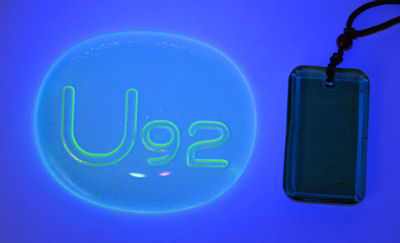

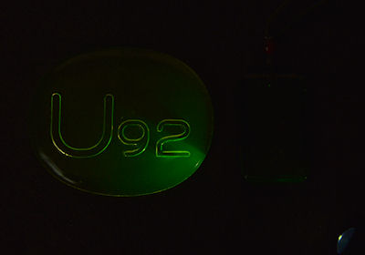

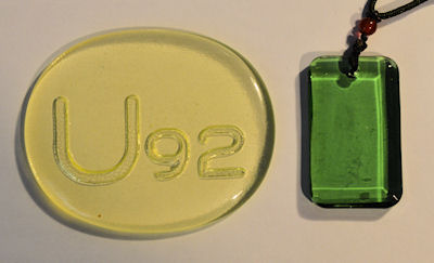

In the comments on the product page I remember reading someone stating it was Uranium glass. Nobody disagreed. On the product page it looked like Uranium glass so I had assumed it was Uranium glass and didn't give it much thought. It isn't. This is Thorium glass. Yeah, I've never heard of that either. I put it next to my known Uranium glass and the colour is very different. The pendant doesn't fluoresce like the Uranium glass at all and after 12 hours of sampling with my Radiacode, the spectrum clearly showed decay chains from Thorium. Lead 212 (Pb-212) was very apparent and is a decay product of Thorium 232. Pictures below show the visual differences between the 'Thorium glass' and the Uranium glass in order of normal light, UV light on bright background and UV light on dark background.
So how spicy is this? Hot or not? It is considerably scary it is thought these should be worn. It comes in at 3.7 uSv/hr (on my GC10next) which is almost an order of magnitude higher than the stone looking pendants using that counter. For comparison my Uranium glass is about 2.5 uSv/hr on the same counter and that is three times the mass than the Thorium glass.

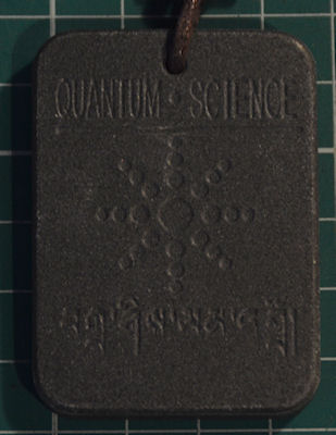

First the pendant. I'll not say much about it as it is very much like the other two I already have shown. this is a little bigger than the other two and appears to have been bashed about a little as there are marks all over it. I suspect it has been stored in a bucket along with another 1000 of them. Here are pictures of the front, back and on the counter. It measured 1.6 uSv/hr on the GC10next, which is more than the other two but I did manage to get a better surface coverage of the GM tube on the counter, so that could explain it. Also it's mass is a little more than the other two.

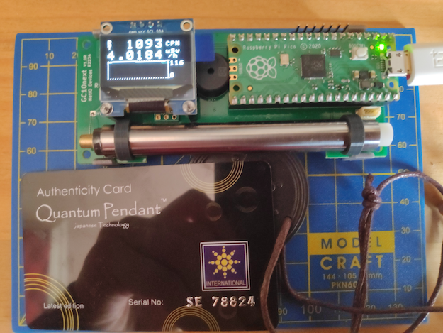

3 years 4 months ago #6454 by steadramon
I've had one of these I've been meaning to test for a while, from the standard Ali website -

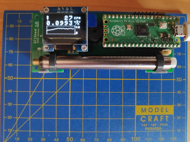

Normal background for my GC10next:
A whopping 1101 CPM
I also got this in a fancy box with "authenticity card"
Nice check source. I find it horrific that these are advertised to be worn.

3 years 4 months ago #6455 by Simomax
Wow, that is way more active than the same pendant I have, by about 8 times! Thanks for posting steadramon.
I have a theory that even the same products are not the same activity, which I would expect with this reconstituted stuff and being made in China probably as cheap as they can. Your results really bolster this theory.
